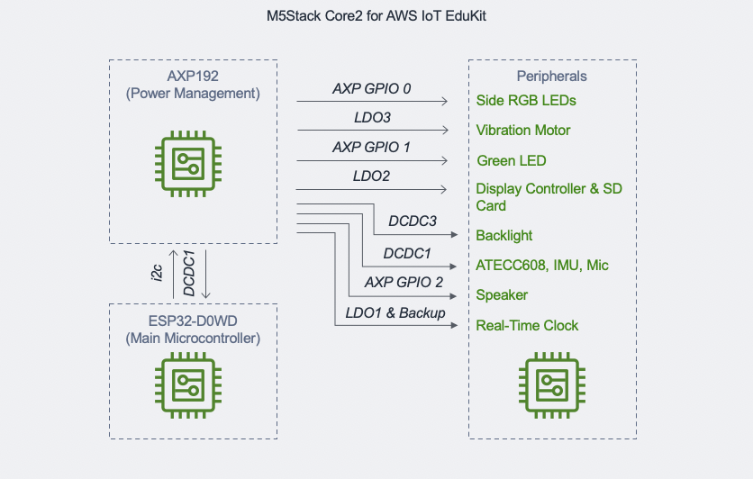

The AXP192 library provides convenience functions to interact with the power management unit (PMU). The initialization function configures the Espressif I2C driver and the power management unit (PMU) with preset parameters.
To enable this feature using KConfig, use the command pio run --environment core2foraws --target menuconfig from within the root of the project directory in your PlatformIO terminal window and go to the menu Component Config --> Core2 for AWS features to set the features you want to enable.
The following example initializes the Core2 for AWS, which initializes the PMU for the battery and other user enabled hardware features. It then prints the the battery voltage using the ESP logger.
