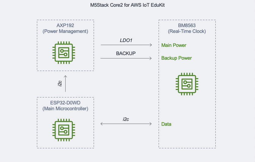

The BM8563 library provides convenience functions to interact with the BM8563 Real-Time Clock (RTC). The initialization function configures the the Espressif I2C drivers and the real-time clock (RTC) with preset parameters.
To enable this feature using KConfig, use the command pio run --environment core2foraws --target menuconfig from within the root of the project directory in your PlatformIO terminal window and go to the menu Component Config --> Core2 for AWS features to set the features you want to enable.
