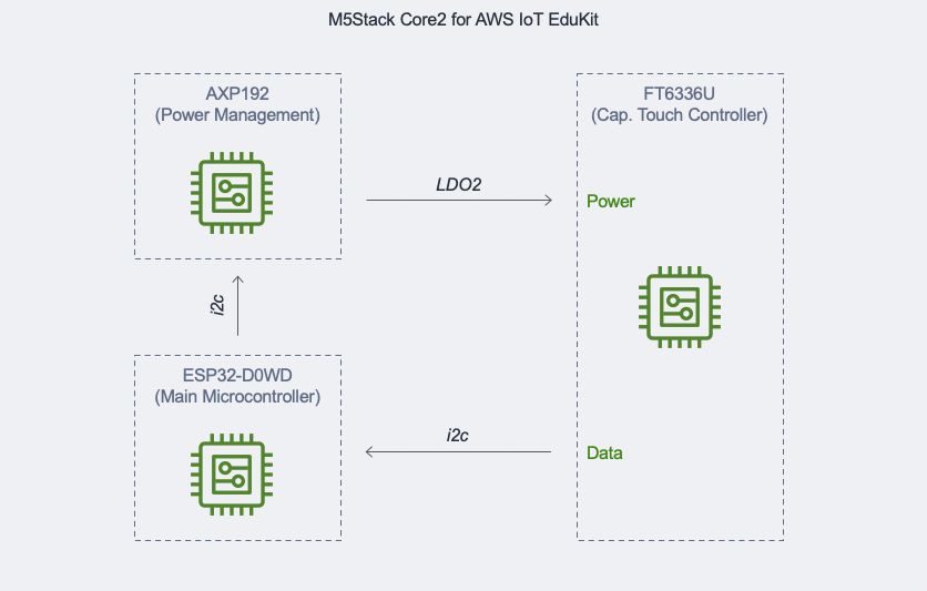

The FT6336U library provides convenience functions to interact with the capacitive touch panel. The initialization function configures the Espressif I2C driver and the FT6336U capacitive touch controller with preset parameters. It creates a FreeRTOS task and installs an ISR on the interrupt pin FT6336U_INTR_PIN.
To enable this feature using KConfig, use the command pio run --environment core2foraws --target menuconfig from within the root of the project directory in your PlatformIO terminal window and go to the menu Component Config --> Core2 for AWS features to set the features you want to enable.
The following example initializes the Core2 for AWS, which initializes the PMU for the battery and other user enabled hardware features — such as the FT6336U. It then creates a FreeRTOS task of priority 1 that prints "PRESSED!" using the ESP logger if the screen is pressed anywhere.
