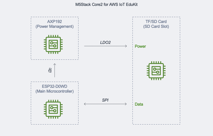

The SD Card functions wraps Espressif's virtual file drivers for the SD card slot. Reading/writing to an inserted SD card can use the standard C functions fopen or fprintf. The SD Card must be unmounted before removing if the device is on to avoid data corruption. Visit Espressif's virtual file system component docs for usage. Maximum supported SD is 16GB and requires the use of a FAT/FAT32 partition table and the feature's symbol must be enabled.
To enable this feature using KConfig, use the command pio run --environment core2foraws --target menuconfig from within the root of the project directoy in your PlatformIO terminal window and go to the menu Component Config --> Core2 for AWS features to set the features you want to enable.
- Note
- This feature requires the ILI9342 display to be enabled.
The SD card and the screen share the same SPI bus. In order to avoid conflicts with the screen, you must take the spi_mutex semaphore, and then call spi_poll() before accessing the SD card. Once done, give the semaphore so that the display can go back to using it.
