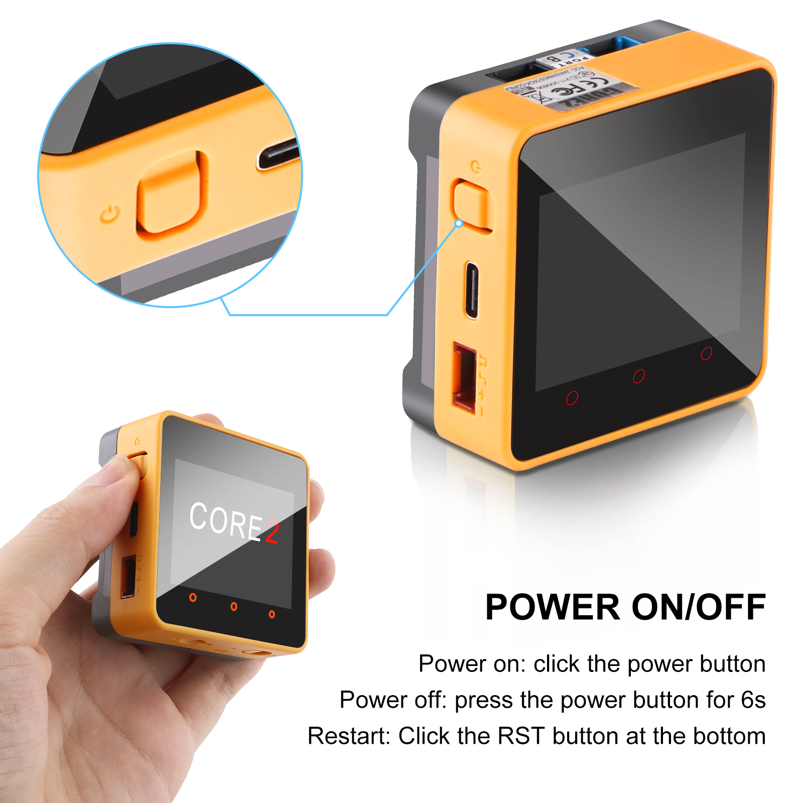

If you haven’t already, unbox the Core2 for AWS and connect it to your host computer’s USB 2.0 port using the supplied USB-A to USB-C cable. (You do not need to use the hex key that is included at this time. This key is used to install additional modules that are sold separately.)
The device should automatically turn on when you plug it in. If it doesn’t, press the power button.
